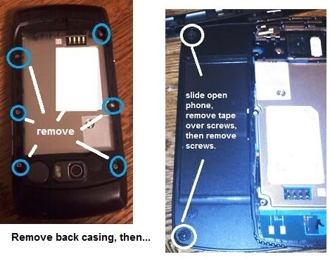

    If you attempt to disassemble your phone yourself, it is at your own risk. I am not liable if your phone is bricked or otherwise destroyed. I think this may also void your warranty. I did this once already to see if it worked, and then I did it a second time to make this tutorial. Enjoy!
    Ok, first remove your battery. Then...

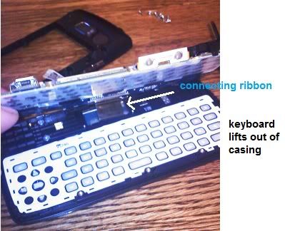

    Now, the circuit board should lift out.
    A small black ribbon which connects the screen to the keyboard will hold the whole thing together, don't rip this thing out !

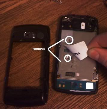

    I forgot to take a picture of the next step and didn't realize this until my phone was re-assembled. Oops. Anyway, after you lift out the keyboard, you will be able to access the other 2 black screws which are on the back of the screen panel. I held the slider half way in/out to remove the screws since they are not accessible if the slider is fully extended or closed.

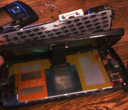

    You should be able to separate the screen panel and will see the back of the LCD screen. The black ribbon runs through all 3 sections.

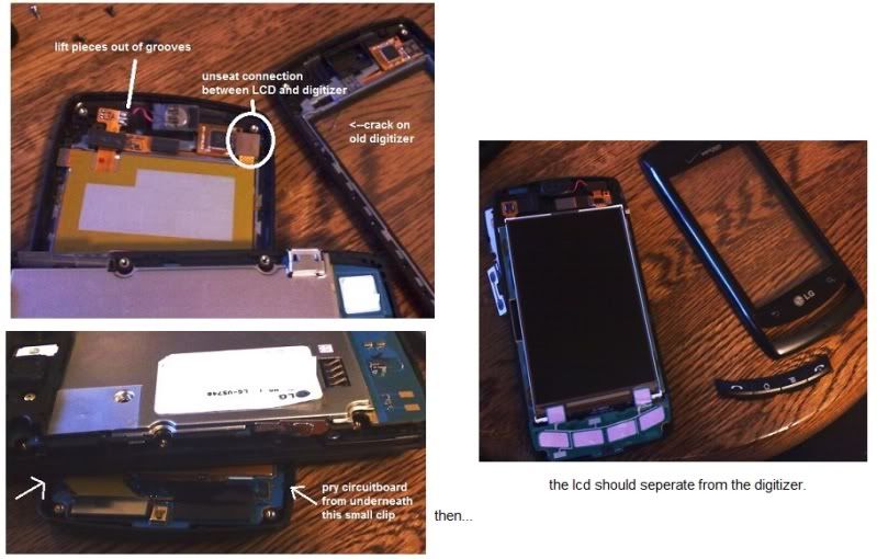

    Carefully trying not to pull out the ribbon, I turned the keyboard/circuitboard sections sideways to begin separating the LCD from the digitizer.
    Take the time to remove all smudges, fingerprints, lint balls, etc etc from the front of the LCD and the back of the new digitizer...or you will see it on your screen forever!
    Now go in reverse. Don't forget to re-attach the connection of the LCD and Digitizer. There is a very small click when it seats correctly.
