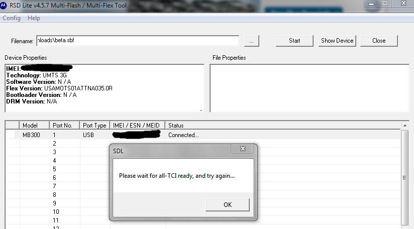

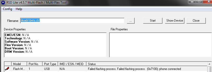

    14
    i have it to the blue screen and it says Bootloader usb int but in the rsb i select the file and shows my phone connected but the start buttons still grey. plz help. lmk if u need pics
    ok now the start shows up but when i push it in start it show this
    and when in recovery it shows this
    it happend when i tried to go to 2.1 beta. i did rename all the things to shorter names
