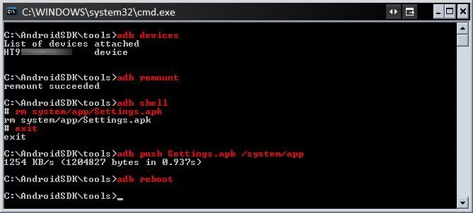

    It may...again, make sure USB debugging is enabled on the phone, and the correct apk is in your SDK tools directory. Then try these commands to delete it and push the new apk via ADB:
    Code:
    adb devices
    adb remount
    adb shell
    rm system/app/Settings.apk
    exit
    adb push Settings.apk /system/app
    adb reboot
    Should look like this in the command window with the text you'll type in red:
    Give that a shot...

    I just tried swapping again on my phone and it went fine. Are you're 100% certain you typed it exactly as I showed? Including the capitalization of "Settings" in the commands? The file MUST be called "Settings.apk" and the command MUST be:
    Last thing...do you have "Hide extensions for known file types" disabled in your Windows settings? If you're not sure, refer to this:
    How to Show File Extensions in Windows
    Disable it if it isn't already. Then look in your SDK tools directory and make sure the file is still "Settings.apk" not "Settings.apk.apk" or something else entirely...I've seen this happen more than once!
