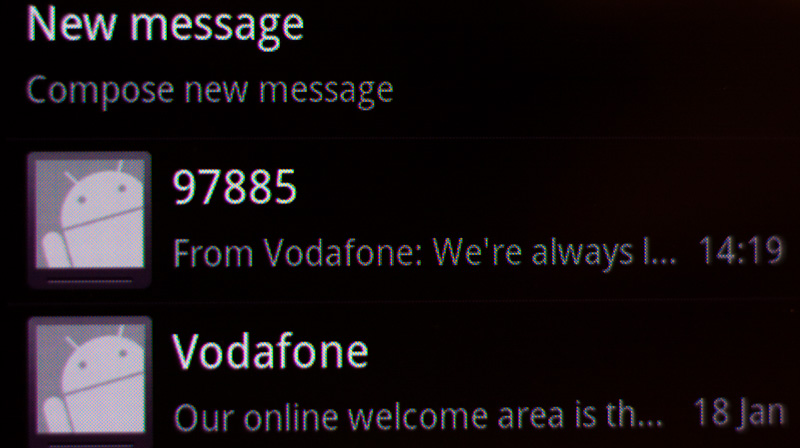

    I would agree that the Nexus One screen can appear grainy at times -- more specifically, it's not the entire screen, but it's text. It appears to affect grey text more than it does pure white text, and it's a minor issue, but it is noticeable to those who are used to high-resolution LCD displays.
    I have taken a couple of better photos to try and show the grainyness issue -- as I said on my Flickr comment, I believe this is completely normal behaviour, and an effect of the pixel layout of the OLED screen, possible combined with the sub-pixel anti-aliasing that the Android OS performs. Apologies for the quality, I took them in a rush so they're a bit out of focus at the edges.

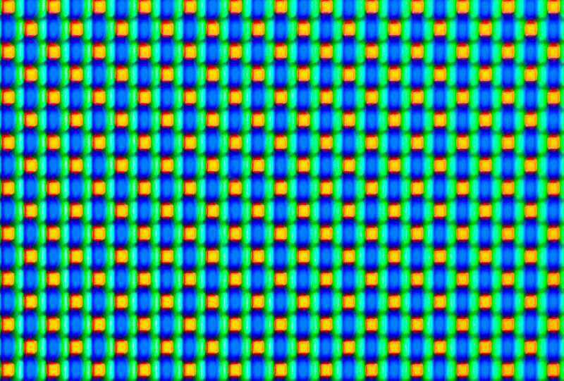

    First, we need to see how the Nexus One screen differs from typical LCD screens. In a normal LCD screen, each pixel is made up from three subpixels, a red, a green and a blue. These are typically ordered the same way everywhere, so if you look very closely (through a magnifying glass or similar) at a white screen, you'll see the pattern RGBRGBRGBRGB across it. (Some LCD displays use a BGR arrangement but these are rare).
    The Android OLED screen differs from this, however, as can be seen below:
    As you can hopefully see, there are in fact twice the number of green pixels as there are red and blue pixels on the N1's screen, with the pattern going RGBGRGBG etc. I've yet to figure out what a 'pixel' on this screen is, as having four pixels across is too wide compared to one pixel up. Interesting.
    Incidentally, I believe the reasoning for this is that the green LED pixels aren't capable of going as bright as the red or blue ones, so in order to even this out at high brightnesses, they need twice as many green pixels. I think this slightly over-compensates as at full brightness the N1 screen has a very distinct green colour bias.

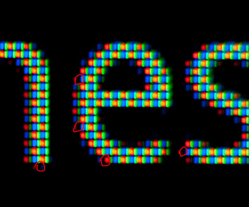

    Now if we look at some text, we see some interesting artefacts:
    For the most part, this image looks correct, but we can see there are some artefacts where we have outlying blue or red pixels that do not have the green pixel in between lit. I've highlighted some examples below:
    I believe this the main cause for text appearing 'grainy' when viewed up-close.
    I have two possible theories for why this is happening:
    1. The sub-pixel rendering engine in the N1 is not aware of the different pixel layout of the N1's screen, therefore it's not aware that the missing green pixel needs to be lit to correctly perform sub-pixel smoothing. This could be fixed in software.
    2. The green pixels require more current to start to light. In this case, the N1 could actually believe that it was lighting the green pixels at a dim setting, but in actual fact they are not being lit at all. This may or may not be fixable in software -- it depends if they can apply a correction factor to the brightness of green pixel to supply more current to a pixel that should be dimly lit, whilst keeping the current to a more brightly-lit pixel the same. I don't know enough about the video driver to know if this is possible.
    Personally, my belief is that the second issue is the cause behind this. Take the clock application, which has a 'super-dim' mode for use in low-light conditions. Activating this mode makes the screen not only go dim but also become quite red -- it's possible this is intentional to prevent loss of night vision, but I suspect it's because the green pixels are prematurely shutting off.
    Anyway, as said, it's a very minor issue and not worth being concerned about. There would be a slight increase in text quality if this was resolved, but nothing major.

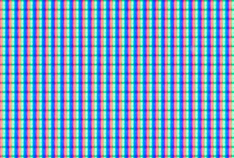

    Finally, it is worth pointing out that the gap between pixels on an OLED screen is far larger than on an LCD screen, as can be seen in the following two photos -- the OLED screen (top) has far more 'black' area between pixels than the LCD screen.
    Obviously this makes the individual pixels more discernable to the human eye and hence will generally increase apparent 'grain' across the screen, regardless of the text rendering issue above.
