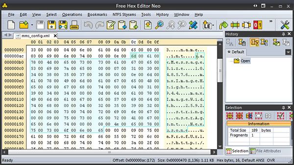

    In this image, I'm showing you a portion of the actual mms_config.xml from the stock app opened in a hex editor:
    What we see there is that the stock app sets the maximum MMS message size limit at 1048576 bytes which is equal to 1024kb. The max picture width/height size are 2592x1944. And finally, the user-agent string is "Nexusone" which some have is not supported by all carriers yet.
    </technical mumbo-jumbo>
    This is a big problem because images between 300 and 1024kb are not going to trigger the resize option! The bottom line is that the stock messaging app maximum values are set WAY too high for most carriers with the 300kb limit and the carrier will not deliver the over-sized message. This leaves you with only a few options.
    1. Take your pictures at no greater than 1280x768 if you plan to send them via MMS. Test this by taking a picture with the smallest image setting and then send an MMS with that image attached...if your APN setting are correct, it should be delivered. That is unless if your carrier has an issue with the user-agent part.
    2. Use Handcent or ChompSMS and change the settings in that app to reflect the 300k maximum. These apps are much more robust than the stock messaging app and should appropriately resize the image for you. If that doesn't work, some users have reported that changing the "Custom User-Agent" setting to spoof your phone on your carrier's network as something other than "Nexusone" has been successful...I'd try "Default Android" or "iPhone (3.0)".
    3. Lastly, If your phone is rooted, you can push a modified Mms.apk on to your phone and overwrite the stock version. These modified versions usually change the user-agent string and reduce the maximum message size to 300k and maximum image size to accommodate the 300k limit. These can acquired at the XDA, Modaco, and Cyanogen forums if you search.
    I hope all this information helps you and anyone else having problems sending MMS messages! Good luck...
    Junior Member overide's Avatar
    5
    kc.rkitek,
    You were spot on.
    I checked the file size and indeed the default settings of the imagine was huge. Even after the "resizing" when i attached an image to the sms.
    I scaled down the image size, cropped it smaller and sent out a 53kb file with my default APN setting.
    It's quite misleading, cos the N1 does tell you that it's "resizing" and yet it still doesn't go thru.
