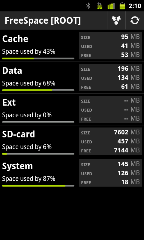

    ok so this is what free space says...im assuming i dont have my old partition anymore.

    Agreed, it looks like you don't have an ext partition.
