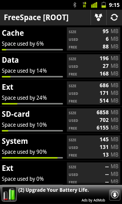

    ok so i did everything this is what free space says now
    its much better. a couple things tho, most gaps still say they are on the phone and when u go to move them to sd card it still wont let u. also some widgets still wont work unless the program is stored on the phone, i thought DT was supposed to bypass that?

    Question any reason why my partition would disappear? Name:  uploadfromtaptalk1308163628151.png
    As you can see its not there,I have a 8gig SD card my partition is 2gig but I don't understand what happiness,I did show it,I flash cm7 and had to reinstall free space and now its gone,my SD says 5+gigs of space but the partion is not showing up
